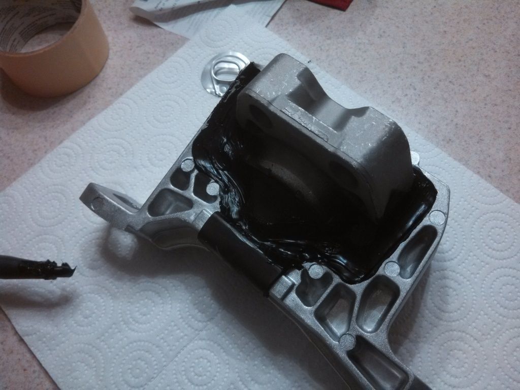

A lot of the aftermarket mounts are poorly designed or just too stiff. Plus all it will really take to make the stock mount good is to fill the giant air gaps with material so it's not able to stretch itself to the point of breaking.
Started off by taping off the one side to contain the mess:
Then used this 3M Window-Weld to fill in as best as possible from the side shown here. The stuff is THICK so once it's stuck it's not going to run or anything... so I filled it best as possible, then flipped it over, peeled off the tape, filled from the opposite side, then used my fingers in a glove to smooth it out a bit so it doesn't look like complete crap:
I did this on 6/11... going to let it cure until 6/15 and install it... auto-x on 6/16.
Going to buy a rear motor mount and do the same thing with the remaining window-weld at some point in the near future.
I did this my my RMM on my old car (before it got totaled.) It definitely helps, and it's a happy medium between suck and poly. That windshield weld is pretty thick stuff even before it sets, so I'd advise anyone using it to have a decent quality caulking gun ( I bent the handle on my cheapy just squirting the stuff into the mount). I believe 4 days to cure is probably conservative, as I gave mine 8 hours and reinstalled it. I did let it set for 24 hours before driving though.

I'm not entirely sure... I think it was losing a signal from the wire. Here is a graph vs MPH as indicated by the dynomometer. I had graphs of each printed out should there be an issue comparing the before vs the after on one or the other.
As for the torque curve, I think that has a lot to do with my craptastic worn motor mounts.
I've noticed a huge difference in the pliability from the 24 hrs after filling the mount, to 48 hrs, and now at 72 hrs(just checked) it is basically solid.
Stock with no filling you can twist the mount by hand with relative ease quite a bit. At 24hrs you can tell only the outside is cured as you can still move the mount pretty easily and watch the stuff stretch. 48 hrs it was noticeably stiffer but when poking the window weld you can tell it's not quite 100% cured... and just checked at the 72hr mark you can feel it's stiff as it will probably get, and doesn't feel gooey at all when pushed with force. You can barely flex it by hand now except when exerting a lot of force on it.
I think 3 days is probably about right. Doubt I will see a difference tomorrow but will report if I feel otherwise.
My main reason is aftermarket mounts = $$ and I don't have the time to bother fabbing my own, though I MIGHT go that route for the RMM since it's very simple to do. I could even just make a big empty "hole", but a sleeve for the bolt to go through, hold it all in place and fill the space with window weld... making it my own bushing. Actually that sounds like a pretty darn neat idea... it will only cost about $20 in materials at very most. :lol:
i'm going to do the same thing with JB Weld and see how it turns out. i looked on their website and the breaking points are way higher than anything it would see in this application
JB Weld is going to be MESSY as hell... I hate the stuff personally.
Are you changing classes - the 'work' you did to he motor mount is not HS legal.
Yes, I've been running in STF since event #2 this year. The ECM tune is not legal for HS either. I look forward to see if it's a really noticeable difference this weekend.

Don't recommend JB Weld for this application. You need some flex to allow the engine to align itself, and I'd be concerned about breaking the aluminum portion of the mount.

On another note, the motor mount got installed yesterday, feel a few minor vibes at idle, more noticeable with A/C on but overall not bad at all. Nothing like my Jeep was with poly motor and trans mounts. If you have any experience with them, it's about comparable to a PT Cruiser at idle... those pieces of shit vibrate damn near no matter what you try to do:chuckles:
And when I inspected the mount, a small bit of it squirted out from the center. It was not 100% fully cured. If you look to do this, let it cure for a full week IMO. My old mount was actually not broken(surprising I know), just super pliable probably from the age of it. I may just clean it off and fill it as well to have a "spare" and swap out to refix my brand new mount. FWIW it was the front of the mount that stuff squirted out from... which means it was in reverse(engine torques BACKWARDS when going forwards) or it was under engine braking(or bad shifting... ha). It still very stiff and feels 100% better than before. You can tell there is some compliance in the mounts still when launching or taking off, but the level of mushiness is about what you would expect to be for a stock vehicle(any vehicle other than a Mazda3 that is).

Here are a few pics of my filled motor mount:
And you can see the little bit that squirted out... doh. Let it cure for a full week before using! Luckily this is on the front of the mount, meaning it only loads that side when in reverse or engine braking.
