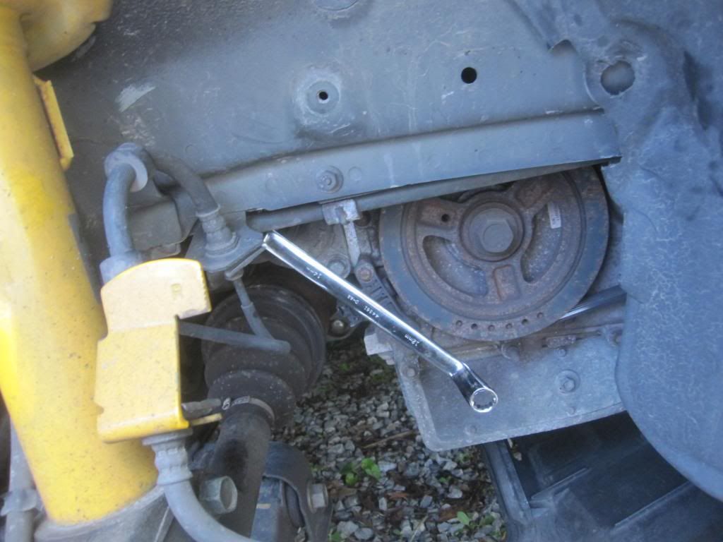

THIS IS FOR THE GENERATION 1 SPEED3.
Initially, I didnt understand how this self adjusting tensioner worked, so I figured I would help you guys out with some pics after my R&R of the serpentine belt.
NO NEED TO PAY SOMEONE TO DO THIS JOB! Its relatively easy.
You dont need but a few basic tools. You only need to jack up the front passenger side corner of the car and take off the wheel, unscrew (1 plastic screw) and two 10mm bolts and push the mud flap out of the way. EASY.
Then put a 14mm wrench on the center bolt of the tensioner pully and push the wrench clockwise, which causes the pulley to pivot upwards and move away from the belt.
Use an offset box wrench if you have one. 14mm.
See picture below:

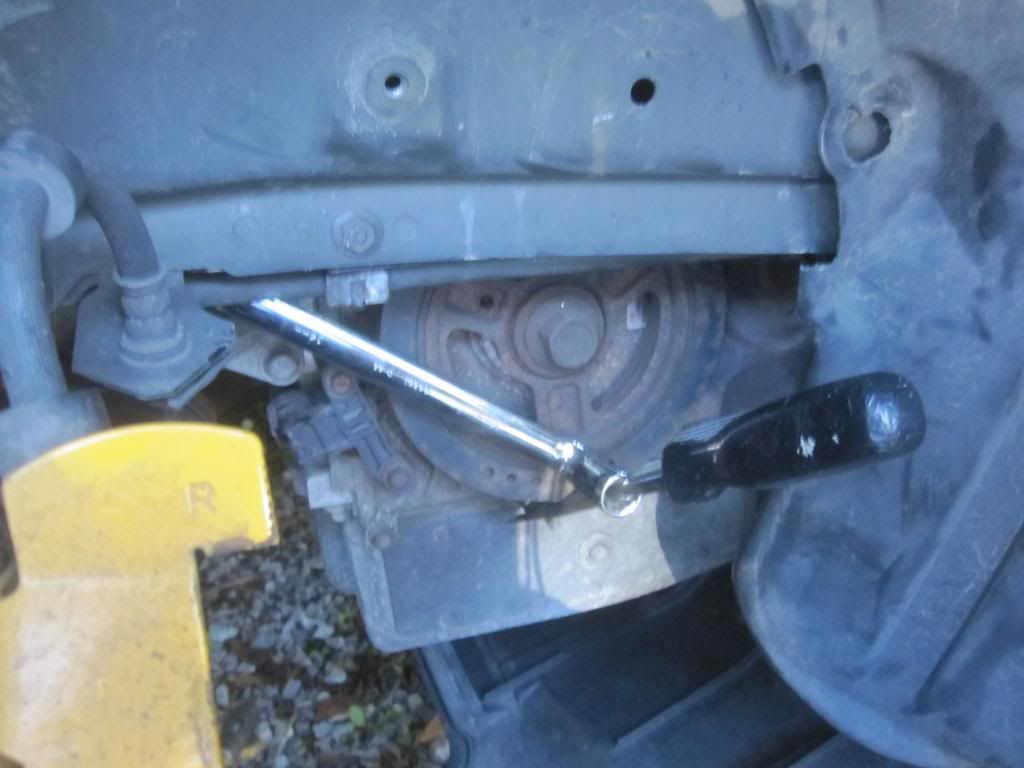

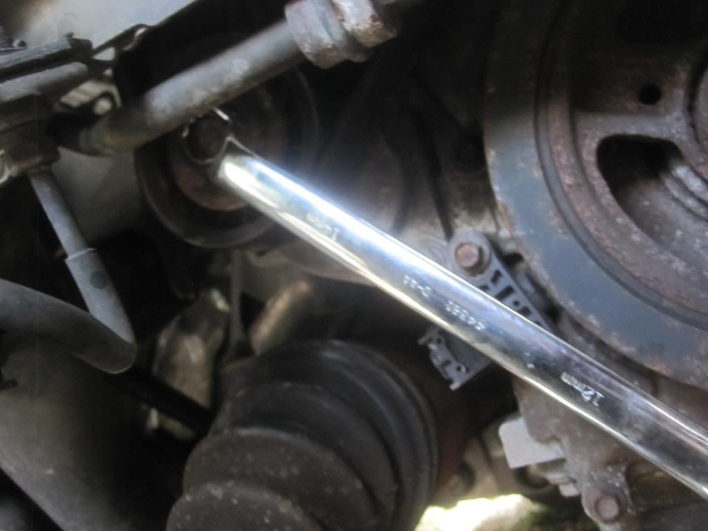

Once the pulley is away from belt, just pull the belt towards you, release the tensioner pulley and pull the belt out from the top after you unlooop it from the various other pulleys.
The tougher part is feeding the new belt in to follow the correct path. Start from the top and remember that you will feed the belt onto the tensioner pulley LAST as this is where you have the ability to make a little bit of space by moving that pulley with the wrench.

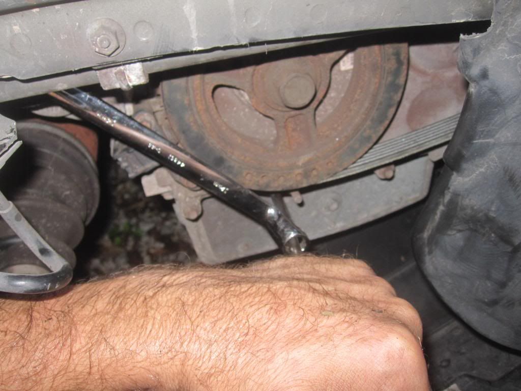

If you're alone like I was, use a screw driver, for example, as per the picture below to help hold the tensioner pulley as you sort of jimmy the new belt onto the tensioner pulley with ANOTHER phillips head screw driver. It will fit but it will take some prying to get it on there. You might even use a little lithium grease on the shaft of the second screwdriver to help it slide down the screwdriver and onto the tensioner pulley. Be careful not to cut into the new belt.
In the picture below I hold the tensioner pulley out of the way with my LEFT hand on the screw driver (which I am using for additional leverage, as the tensioner pulley is under a lot of tension) while I use my right hand to jimmy the belt onto the tensioner pulley with another screw driver. I am pushing down or clockwise on the wrench in this picture. The black screwdriver just helps me keep the wrench in the down position.
