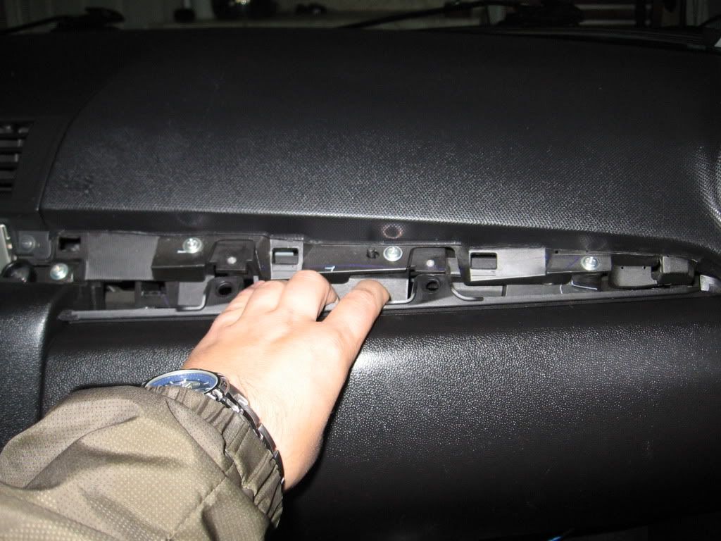

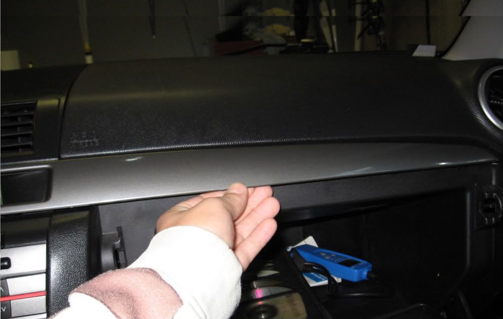

1. Open your glovebox. We want to remove the silver strip above the glovebox. There is a cut out, right where my hand is in the picture. Start popping it out towards the LEFT. There is a hook on the right end which slides out to the left(see picture).

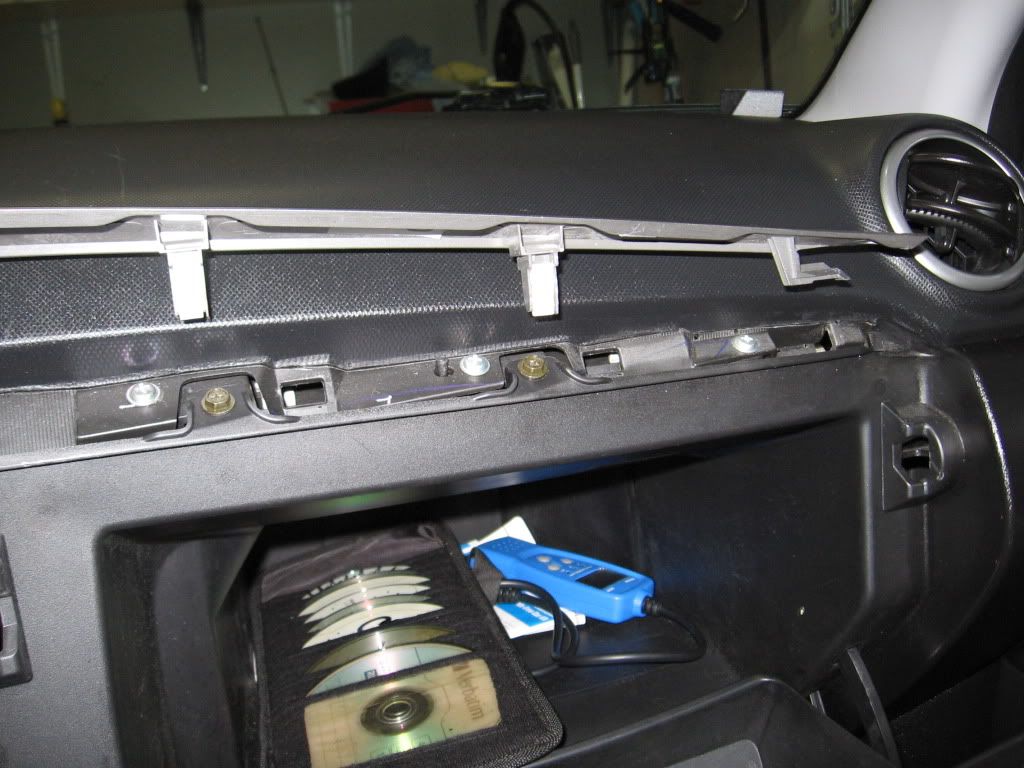

2. Remove the two brown bolts at the top of the glovebox. Use a starhead screwdriver or 8mm socket.
3. Once those two bolts are removed pull the glovebox towards you. I put my knee under the glovebox to support it and to keep it from falling down.
