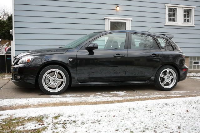

here are my 17" winter tires. you can see there is not much room.
