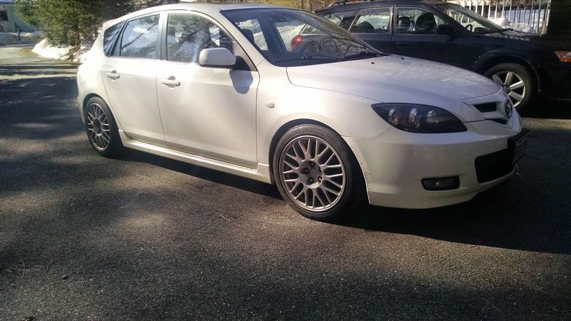

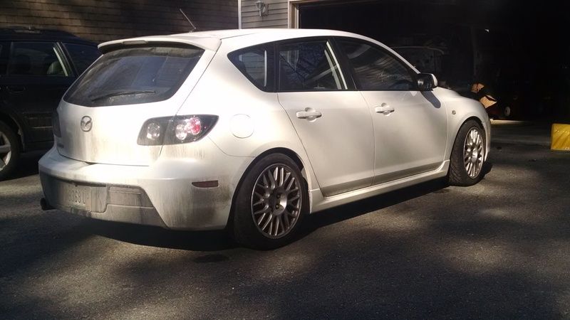

Test fit my 17x8s over the weekend. She a dirty little thing. :)
The tires that are mounted are 215/45-17 BFG Gforce T/As and are completely shot. Started looking for budget summer tire replacements (V12s are my favorite budget tires so far...) and realized there is no way I can replace these for less than what I paid for the 225/45-17 ZIIs in the basement @ $100/pc. So instead of selling the ZIIs, Im going to run them as my summer tires. I spent the last 3 summers on ZIIs in my Honda and the Evo and never had any issues. So it looks like I'll at least be on good tires if Im running these wheels in STX for an event or 2.

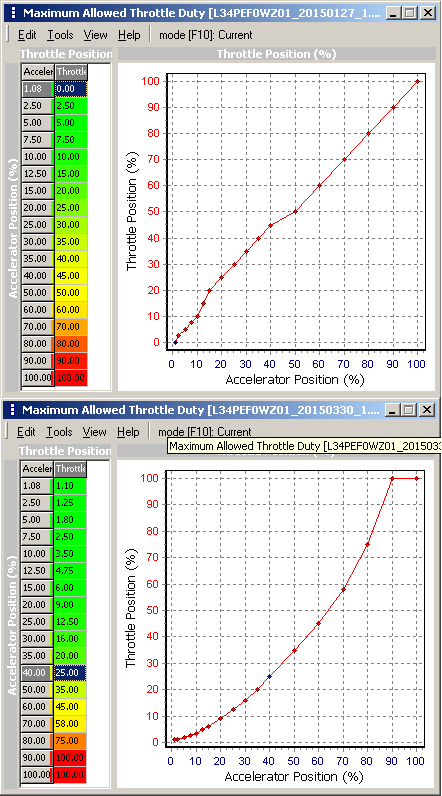

Ive been looking at the Drive-by-Wire system over the weekend. Apparently, automakers program cars these days so that the ECU is constantly trying to add as much Throttle Plate as it can in order to make the car feel more peppy off the lot. One of the parts of the DashCommand app shows you the difference between Pedal Angle and Actual Throttle Plate Angle and it was sometimes 30deg difference!
Read this article and the maps I have are really similar in look and the original tunes are similar to what I had.
http://www.dirtyimpreza.com/forums/show ... Improve-it
So:
Load is the measure of available TQ. More Load = more potential power. So when 30% Pedal Angle = almost 80% load, you've just turned that 80% of available torque into only 30% pedal angle and the 1st 10% is mostly a dead spot so its more like a 20% range. 100% Throttle Plate angle is achieved long before 80% Pedal Angle too. In the example provided in the link, he numbs it down so that the load values are more linear to actual Pedal Angle and removes the ECU's instructions to add more.
It Works! I still need to fine tune it. But it works. Feels more sluggish from a dead rest, that's the part I need to fix. But the rest is spot on. The last 10-20% of pedal travel never seemed to make a difference, but now it does. Now it doesn't go 100% until I bury the pedal. Im always spinning an inner tire pulling out in traffic and now its controllable. Should have the same affect on the course.

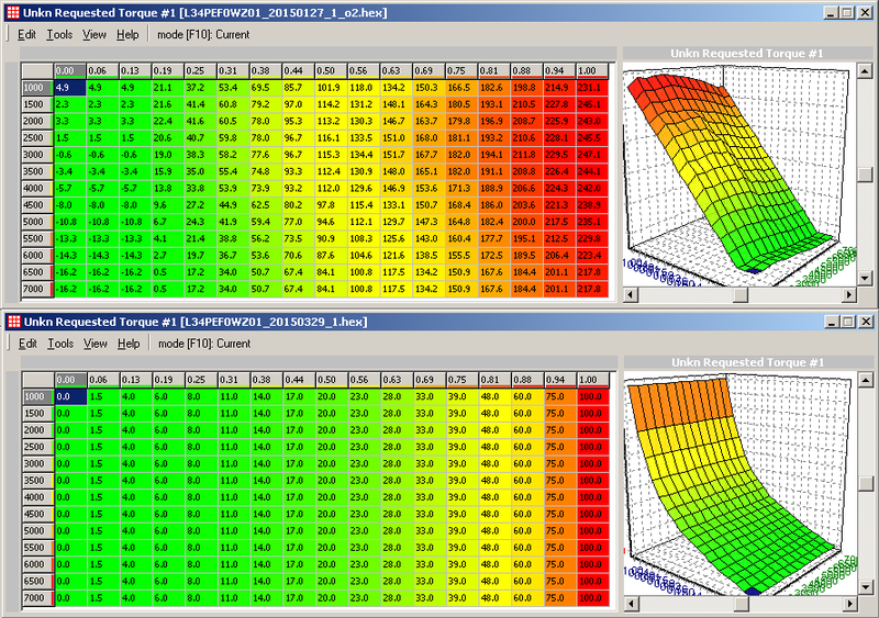

Here are my throttle duty and requested torque maps. Ive intentionally set both up to 90=100% since the ECU never registers above 90%, but I don't think its necessary and I think Im going to move it back to 100%. I didn't go as extreme in the link provided, but Im still not done with it. The several (gear dependent?) other throttle maps match the maximum map. It may be worth testing this in different gears as well.
