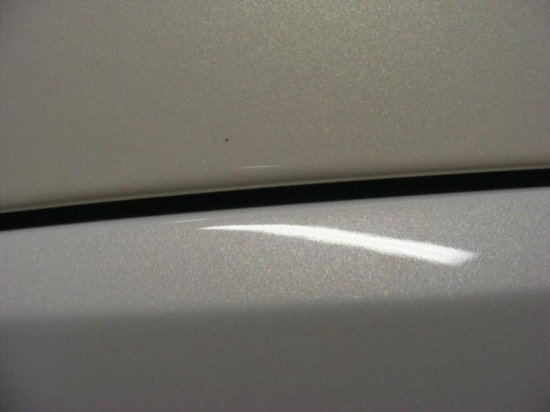

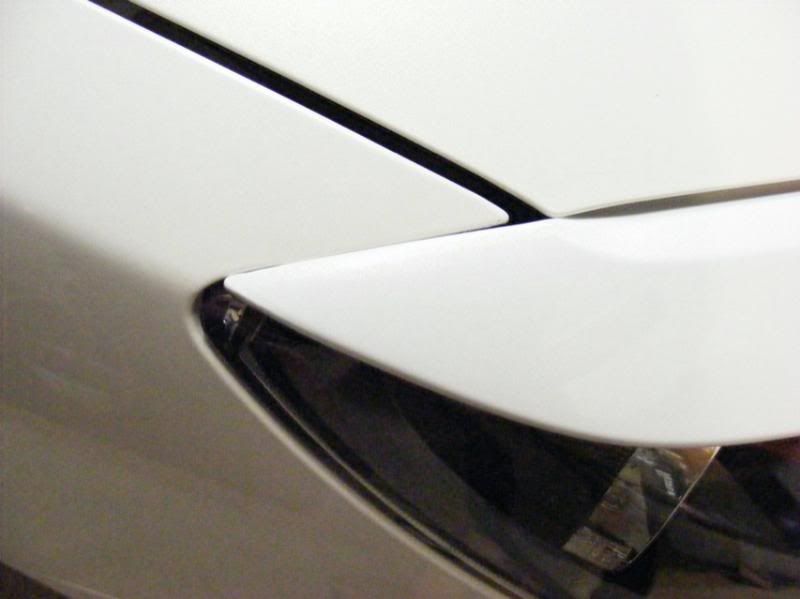

I got some PartsPlaza eyelids from the Groupbuy for my 09 (bought in dec 08) pearl white mica mazda hatch s. I have had them for about 2 weeks and finally got to installing them today to get ready for the local meet next sunday. While test fitting them yesterday I noticed that the colors were a bit different. I took some pics after installing them today because I am not quite won over that the colors are actually the same. Along with the color the fit seems to be a bit off too.

for starters, its near impossible to color match without both parts.
you can paint two things with the same batch of paint 4 hours apart and end up with different results
not only that, but I can guarantee your bumper and fender don't match perfectly either because they are different materials.
as for fit, the fit doesn't look terrible from what i can see in your photos

everyone's eyes are different. so i would say if it isn't painted with the exact same batch and at the exact same time and the exact same way and exact same amount, it may not match. however most of the time it's close enough to where no one can tell... to me it looks like your hood may be a bit dirty or something. the second and third pics looks good, but the first the hood looks a bit yellow or brown, and being white, that may be the problem? try some clay bar.

The problem is that I can't move them any further outside without them overlapping the body panel, but as you can see the curve on the top of it does not match up with the inside of the fender.

take a dremel and work the inside a little bit. I had to do that with my silviaparts ones to get them to fit the way i wanted.

I got mine a few weeks ago, and mine seem to be fine.... Your hood apears to be a bit in the yellow or dirty side.
31,083 Posts
i think he just has a heavier pearl coat...that's why 3 step paints are hard to match.

here's how mine look now...i dremel/sanded the lid to fit the curve of the fender.
the red area is what I removed because it touched the fender rather than matching the curve of the fender. Actually, I shaved off 1/16" along most of that top edge, because it was too close (imo) to the fender. I wanted an even gap (or at least close)
I guess you could pull it in further but I wanted the edge of the fender (parallel to the hood) to flow perfectly into the curve of the bevel in on the eyelids
