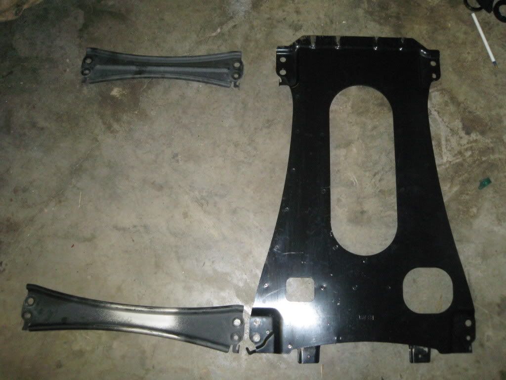

I just wanted to let everyone know, if you didn't know yet, about something I just discovered. The braces that go across the exhaust tunnel in our cars are compatable with the MS3, or should I say vice versa. I just finished bolting these on, but didn't get to test out its toll on torsional rigidity. I also didn't get to take a comparison pic of the front brace (right under the downpipe with the shield for the fuel lines). But here is a pic of the mid brace. MZ3 two single thin braces on the left, and MS3 one piece thick brace on the right. Direct bolt on alternative for G-Spec braces or such for MZ3 owners.

Bolted on the sedan, today, despite the bad weather. The front one and middle one both fit and bolt directly on. I don't think the front one is pictured above, but it spans out wider and connects closer to the jack point. You will need bolts, nuts, and washers for that. I would suggest to have nuts welded into the holes under the car for easier removal and reinstallation if needed. I couldn't drive it because half of it is in pieces, right now, in the middle of another project. But, I'm sure the difference is notable.
