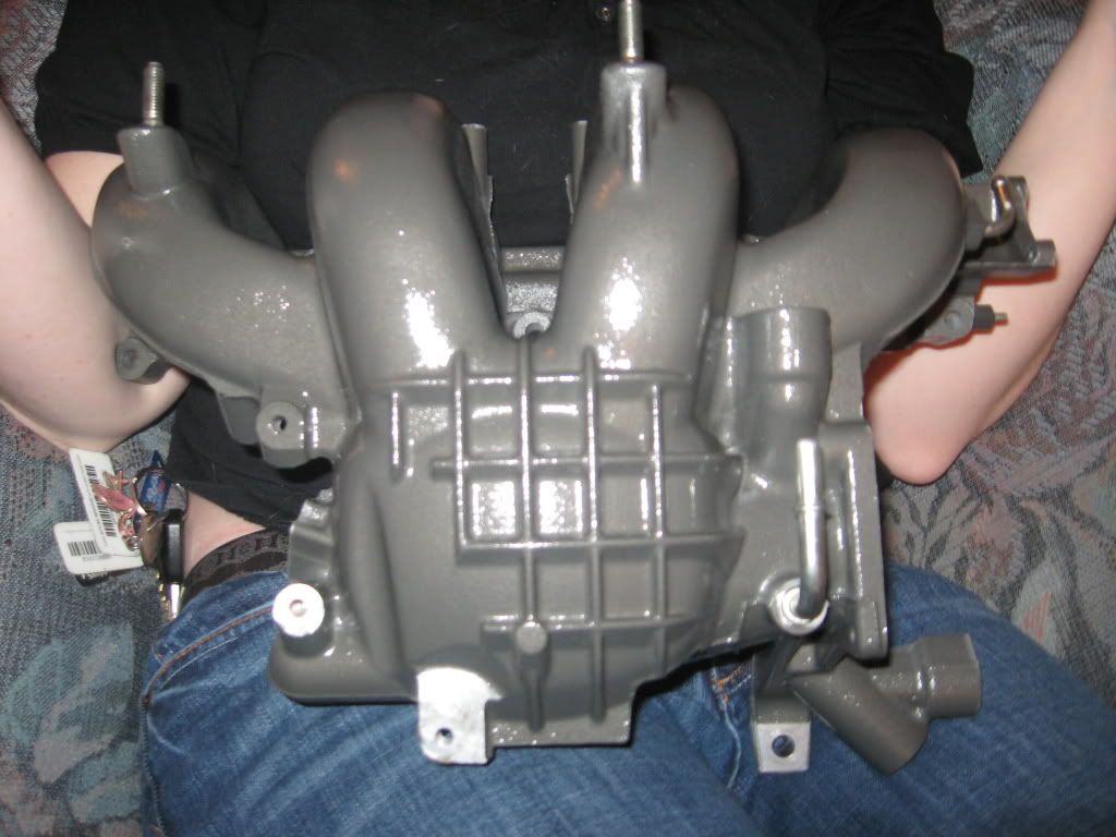

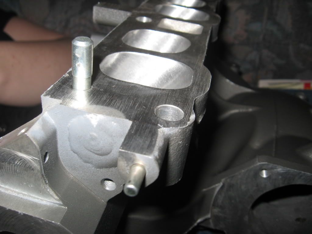

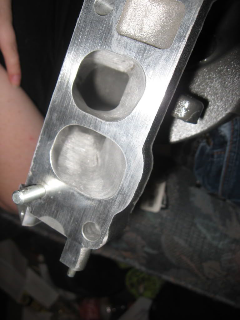

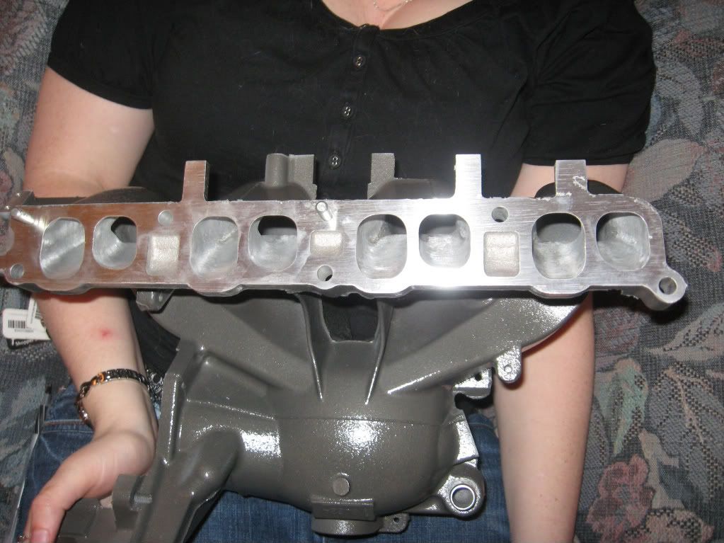

I snagged up a spare intake mani not too long ago because I wanted to step things up a notch during my build. After seeing how restrictive some of the runners were, and knowing how lame the VCTS system is from my previous 3 sedan, I knew there were gains to be had.
And here is the results. I had quite a bit of material taken out of the manifold, the holes for the VCTS system welded up, and then everything was polished up. Also got it coated in the same cast iron color that my valve cover is. Should pick up a nice amount of power off this one.

No pics of the stock one, I'll put up comparisons of the 2 side by side when I install it. I was shocked how much material was removed though, quite a bit was taken off. As far as how long it took, I dunno, I had a local speed shop do it. I coated it myself.

Oh, I'm sure its worth it, just getting the holes in the runners for the VCTS welded shut was worth it alone.

did you have the EGR removed?
what are you going to do about the VCTS CEL?
did you open up the TB area as well? Because the mani is smaller then the TB 60mm bore
you can consolidate vacuum lines as well
what about all of those raised edges and mounts for the vacuum chamber and TMIC that can be hacked off/smoothed?

point of my post was to help him with a few other things that the mani needs other than the VCTS removed and some material hogged out
also you have to watch how much or far you gasket match unless you are porting the head as well otherwise you cause an airflow restriction vs the attempt to promote additional flow
there is a fix for VCTS CEL caused by removing the plunger and solenoid
