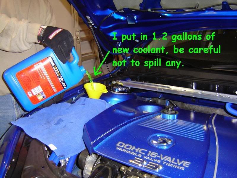

1 to 2 - Gallons of coolant ( see your owners manual )

Also drain 2 times for a more complete flush, this was not needed for my car, coolant was not that dark.

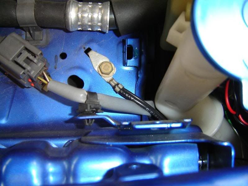

I removed the coolant fill tank for easier access to the lower hose and to completly drain. This is optional, I just wanted to do it. There are 2 clips on the frame which hold this in place, easy to remove, just press on them with your thumb or use a flathead screwdriver. Pull straight up.
Here is the spot where the coolant tank sits.

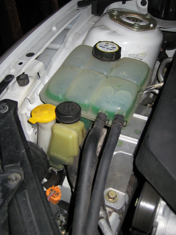

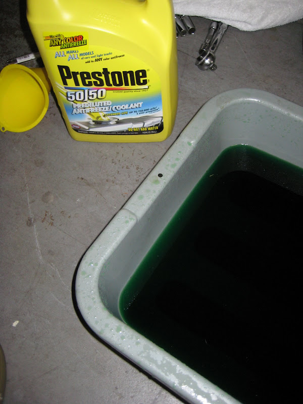

just did the coolant drain and fill, no changing of hoses.
old dark stuff. i had put nearly 40k on the car since i bought it (83k miles). i had a CEL the other week for "low coolant temp". thought it would be a good idea to drain and fill. overall i swapped about just over 1 gallon.
new bright green stuff.

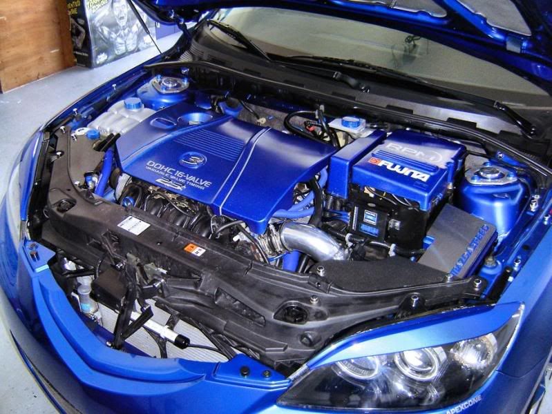

hey tek do u have any pics of the engine bay further away so we can see how the obx hoses look?? thanks..

Really can't see the hoses unless you look down inside the engine bay, but I do have shots from futher away. Well you can see them a little bit.
I will take new shots once my GT Spec brace arrives.
