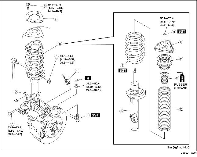

Tighten the important bolts with a torque wrench.
This generally happens if you don't tighten something enough.
do a search on this site for torque specifications/suspension, i think they are on here. if not, call the dealer, they'll know.
2
front.
rear.
I am assuming that the units for the numbers are Newton-Meters {kilogram-force meter, foot-pounds force}.
Am I to understand that it just needs to be in the range of the torque values, i.e for nut #9 it could be torqued at 65 N-M and that would be sufficient??
yep. the most common used is the bottom# ft-lbs.

just like the key/legend at the bottom right of the picture says. :D
Those are useful pictures..
