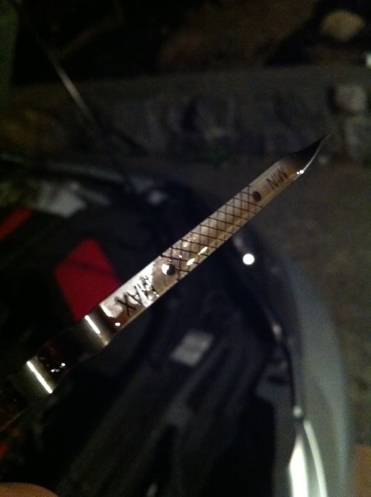

I don't mean to dig this.. but I just changed my oil today, and I think i filled too much :S
The jug said 4.4L, and i dumped it all in.
After driving around for a few minutes, and then letting it sit for another few, the dipstick read basically up to the "M" of "Max" (see pic)
is it alright?
