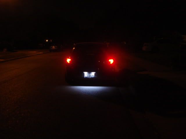

Damn that is bright! A little overkill, but it looks cool.

thats what i was thinking but fuck they are kick ass!
only thing that worries me is that it might be too bright and cause and issue with cops.
hopefully it'll look good with the 07bumper and the dgm valence
i was also thinking bout some custom interior lights seeing as theirs little to no light at all in the rear.

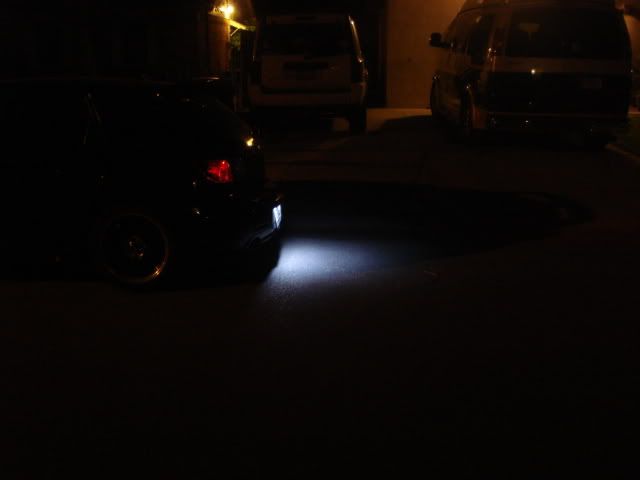

Damn those LED are bright.. Just a thought... do you really want to draw that much attention to your license plate??

Looks like the set I made. It's a pretty easy project, if you've soldered LEDs in the past. The housing & lense just snaps together. I just cut a PC board from radioshack to size, soldered a 10 superflux/pirahna LED array (2 LEDs and one resister per leg) in each housing. Total cost for the mod is about $10 and about 1hr's worth of work.
The only difference is that I modified the rear bumper trim so that both housings would sit closer together, rather than widely spaced.
