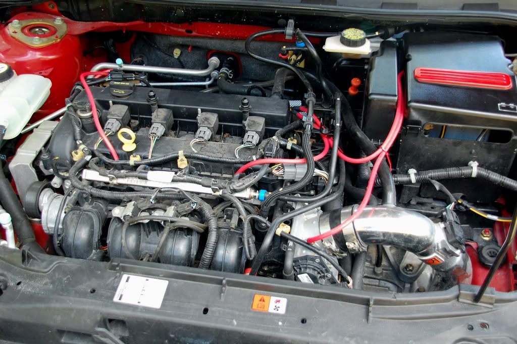

It's the small resevoir sitting all the way in the back, pretty much centered under the hood. It's right up top and has an odd shape with a big black cap on top. Our car uses the same resevoir for the brakes as the clutch, so it's the same fluid in the same place.
It's the little white resrvoir sitting right there, top dead center. Here.
