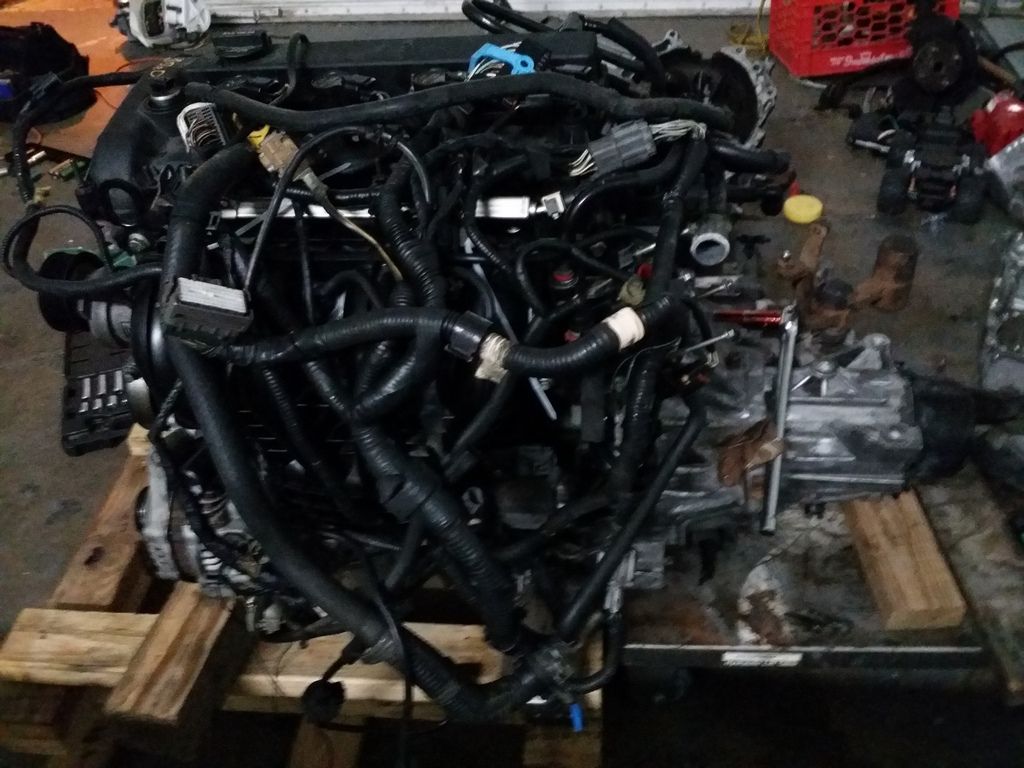

Picked up an intact coolant Reservoir, an intact Mazda valve cover, Fusion VVT connector and Coil connectors which seem to be common to break on the mazdas (The ones in the junkyard were ALL Destroyed)
I need to put the Flywheel on the engine, and install the clutch and then Mate the engine & transmission and its going in the car, But tomorrow is the wifes birthday, so its gonna be on hold a few days
EDIT: This is how i feel about getting the wrong VVT solenoid plug
EDIT #2:
Being that i dont like to give up, i wasnt leaving until i was satisfied............. I dropped in the pilot bearing, torqued the flywheel to spec then torqued the pressure plate to spec, put the new throw out bearing in place and then mounted the transmission.... All Solo, took me a bit of positioning everything properly with 2x4s to get the transmission to slide in, but With a bit of patience and ingenuity, it went together Smoothly
