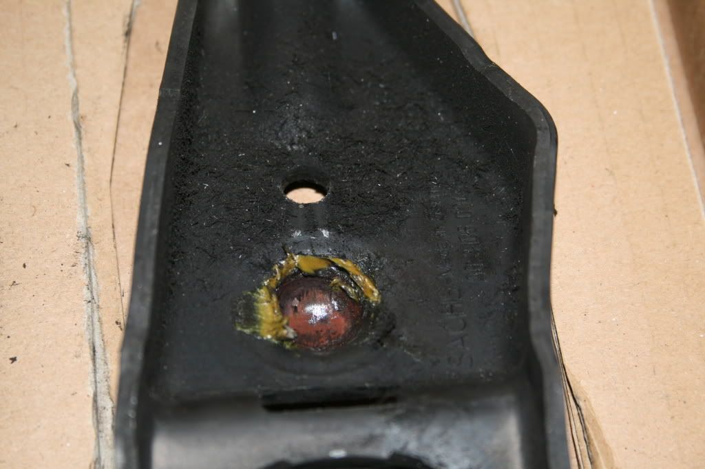

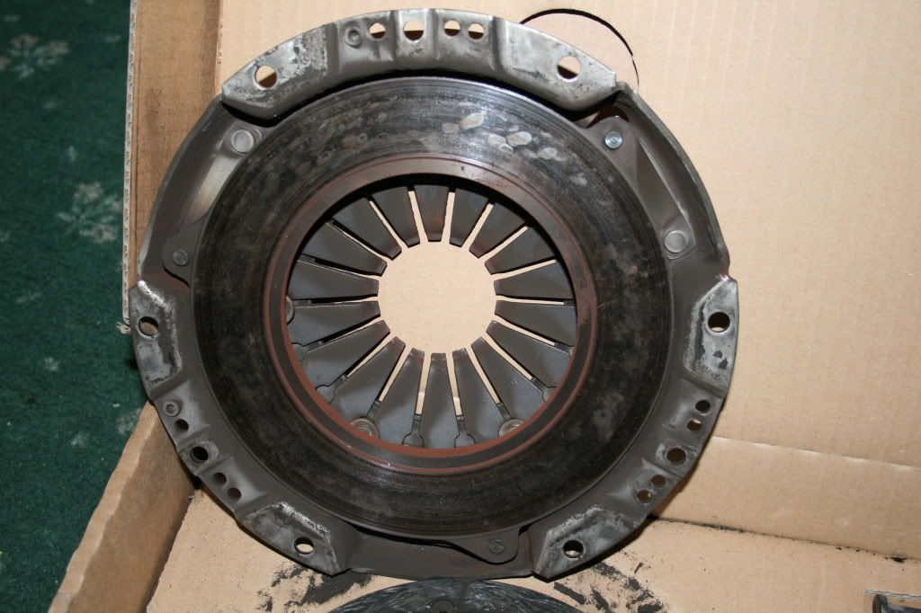

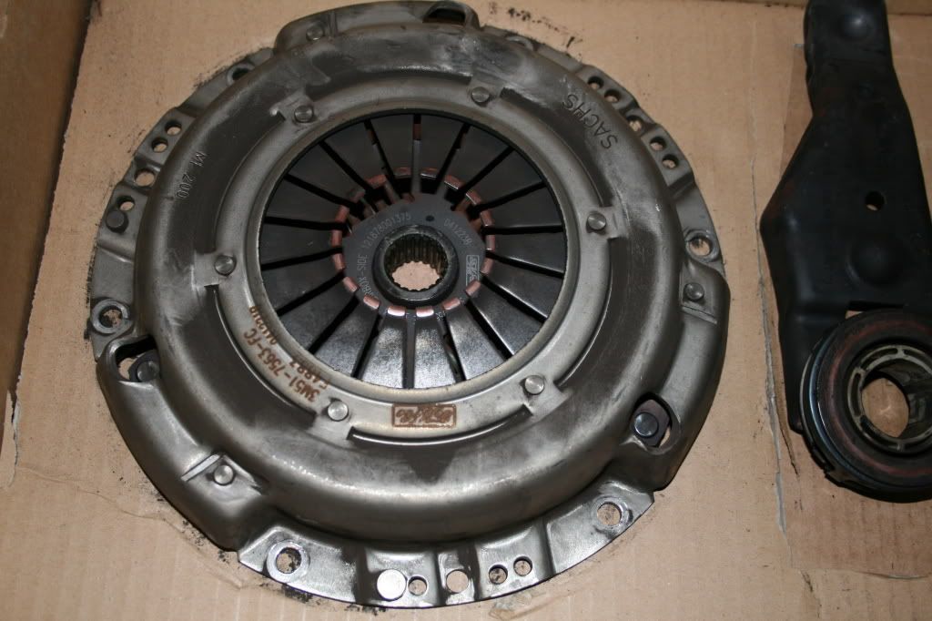

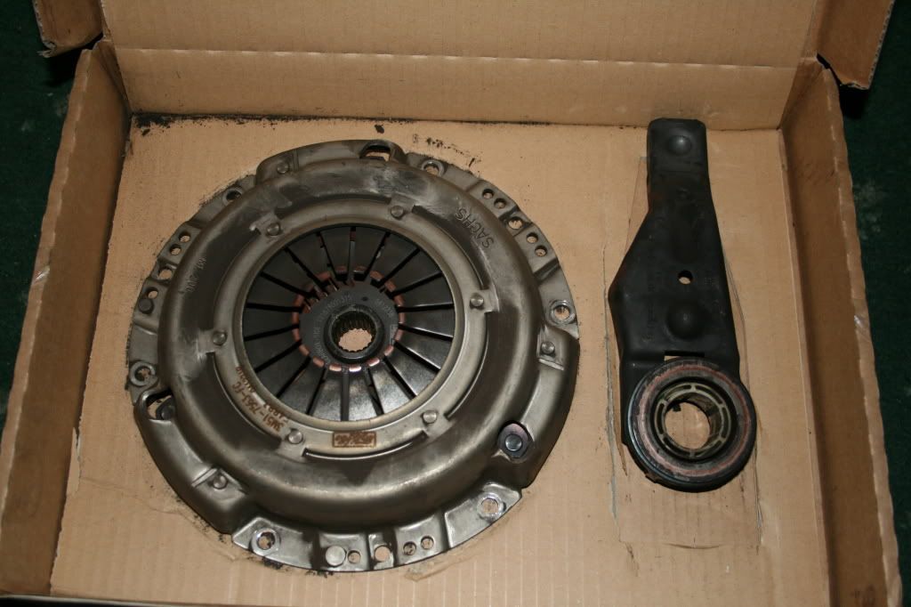

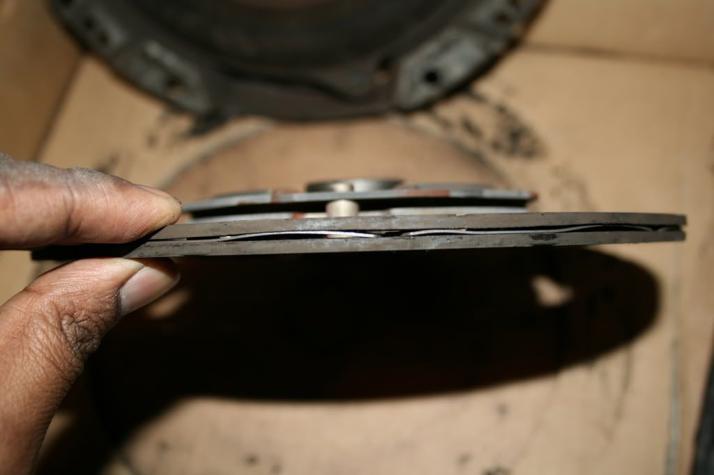

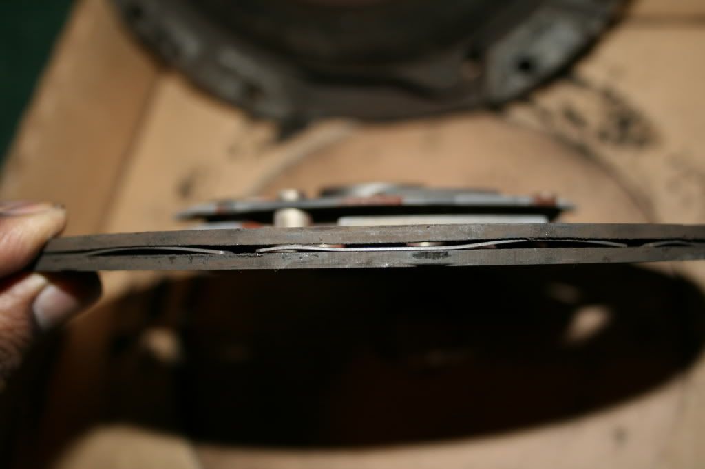

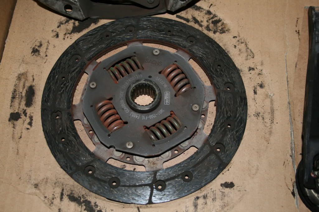

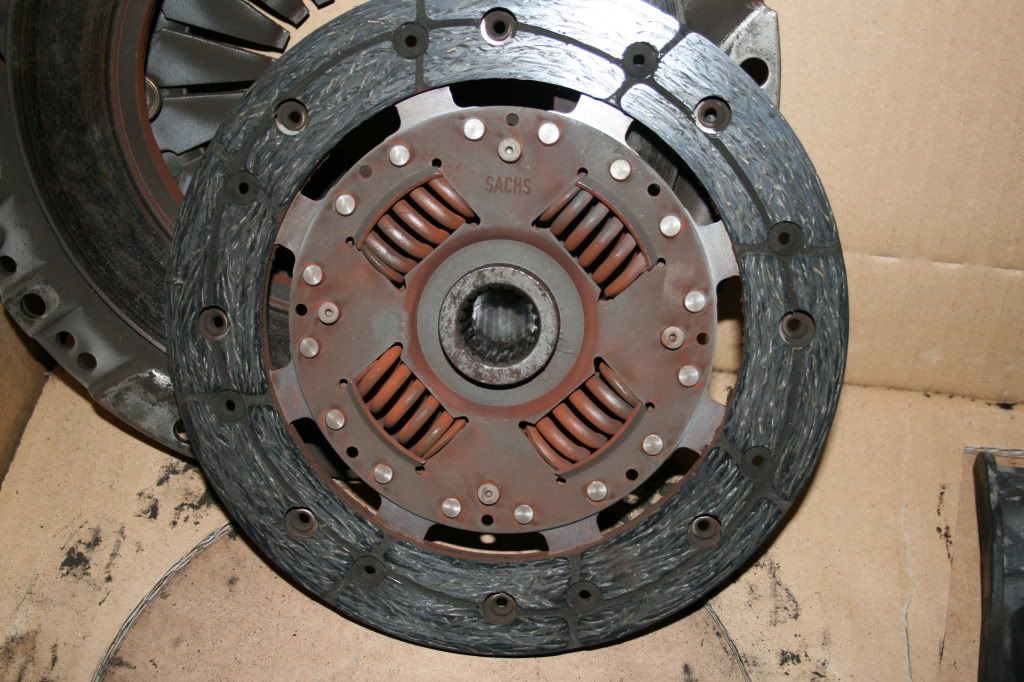

Here are some pics of the old clutch that was removed. now i'm not familiar with clutches.. but can someone tell me whether the clutch does look worn out or still in good shape??
any suggestions?

the pressure plate looks ok still, the disc looks like its been a bit toasty, particularly that end on shot you have that shows it being a bit warped, this is probably what the shuddering is, as this warp to it is making engagement rough.
Probably only needed a new disc, but since they had the whole thing taken apart, it just makes sense to replace the whole thing while they are down there.
25,357 Posts
That disc doesn't look that bad, I've seen a lot worse, but it isn't new, thats for sure. Should have seen the clutch in my Alero when I pulled that thing out, it basically fell apart in my hands.
