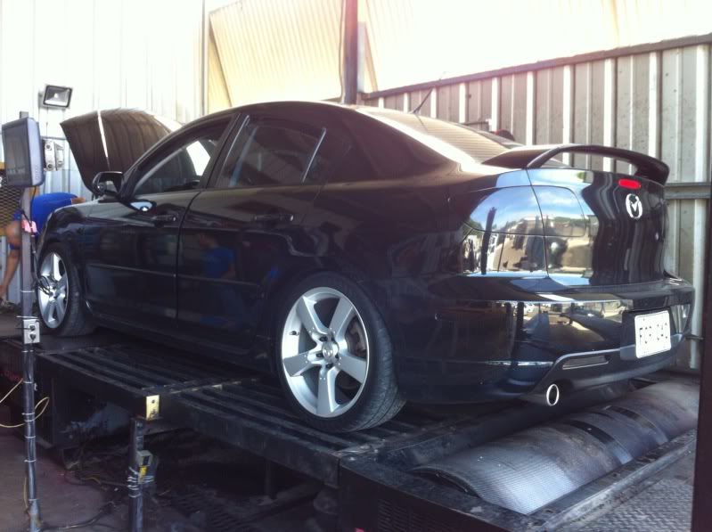

Hi all, just wanted to share with you guys the results of my dyno runs after a local guy did a reflash to my car. I'm impressed!!!
Sorry for the Iphone pics but that's the only thing I had in hand.

final product...
http://i2.photobucket.com/albums/y30...ps37f5a85d.jpg
The torque came down a few points but I'm very very happy overall. Best $200 I've spent on the car so far. :bigsmile: :wiggle:
