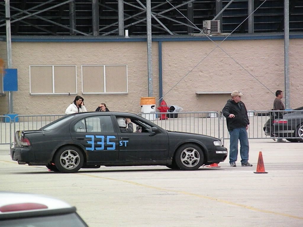

Figure with the amount I have been reading here I would throw my hat in here. Been learning a ton about setups.
Did my first learning event with Windy City SCCA in 2011 in my 1996 Maxima in STS. I had a blast and intended on racing the rest of the season. I only ended up getting out there maybe 2-3 times due to Family health issues. 2012 I managed to get mono and couldn't wrench let alone drive and 2013 my 1990 300zx decided it needed a new motor which killed my budget and time
Koni yellow, eibach springs, y-pipe, catback exhaust and intake and a lot of replacement bushings/metal parts for the amount of rust/wear it had at 190k miles.
