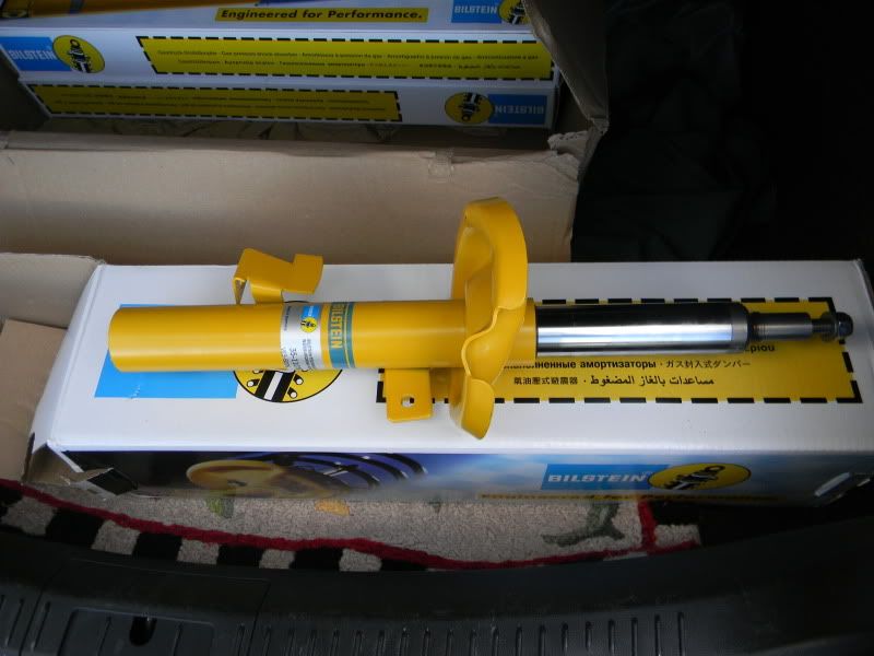

Scott, if it was round to start with I'd just take off what you need to make it work.
I'm going to call G/C today as well and find out a few things, most importantly which option, "stock or Koni" I should choose if I have Bilsteins and what the difference is between the kits. As you can see the bilsteins don't disassemble quite like the Koni and lack that plate you are having issues with.
