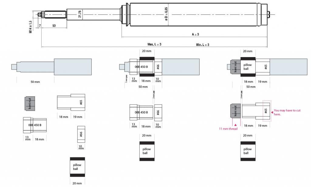

First off, the STF preparations are still in the works. I'm so very close to having a proper ST suspension on the car, it just seems like it was headache after headache, problem after problem, and delay after delay with this setup. Right now, the housings and one of my inserts are back at AWR in California. The inserts I purchased, 8611-1256 are 2mm larger in diameter so they did not fit in the housings, even after completely removing the paint on the shock. Tony said he can bore them to fit and asked to include an insert in the package so he can test fit them before mailing them back.
Had to snap a picture of everything before I sent the housings off.
Another issue I've only recently solved has been the connection between the insert and the camber plate. I have the corksport plates (which are nice and all but I'm not blown away by them, I wish there were some things they did differently but that's beside the point) which have 18mm ID bearings. The pillow ball nut included with the plates are for M12 bolts and my inserts are M14x1.5. I originally inquired with corksport to see if they could send me another set of the pillow ball nuts included but drill them out to 14mm for me. I would then use them as a lower standoff and then use the nuts supplied by koni to secure the shock (not pillow ball nuts, just basic, normal nuts) but corksport came back to me and told this is not something they could do. They told me to try cusco for replacement nuts for M14x1.5 shocks. I emailed cusco for a bit of assistance on which pillowball nuts and collars I should order. The collars are basically the same as the pillowball nuts except come in a wider range of sizes and have no threading. He gave me this awesome diagram to help picture everything and I settled with a m14x1.5 pillowball nut and two different size collars to play around with. The reason I need the collars is because I am using a top hat that keeps the spring coaxial with the shock, so the spring will not be resting on the camber plate like corksport may have originally planned. That issue is basically sorted out and it's just a matter of everything arriving back so I can put it all together and hopefully everything will fit and they can finally go on the car.
These of course are not exact drawings but they help picture everything together.
