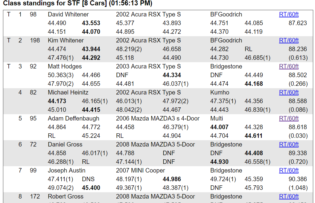

Thanks Scott, tough competition there at Blytheville. Can't say I'm jazzed about a 4th place result out of 6 drivers, but as you said I was still in the game and it was close.
Tire testing. More tire testing. Now that I have two sets of 15x7.5 Slips .

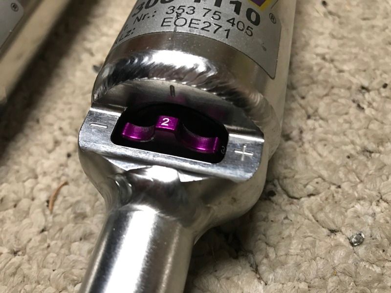

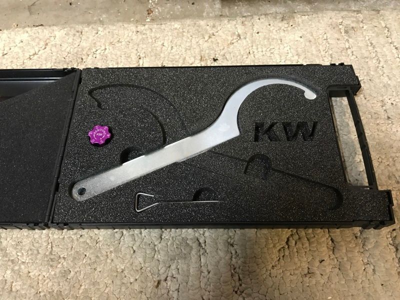

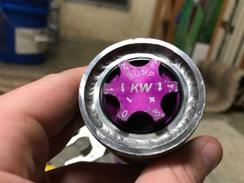

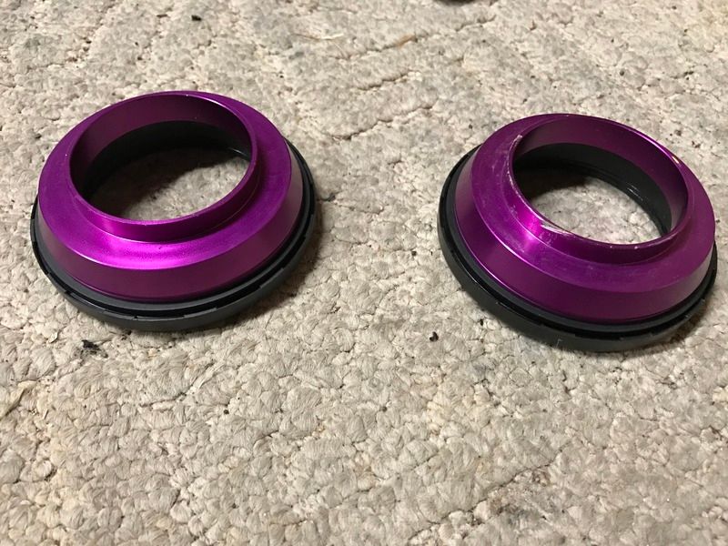

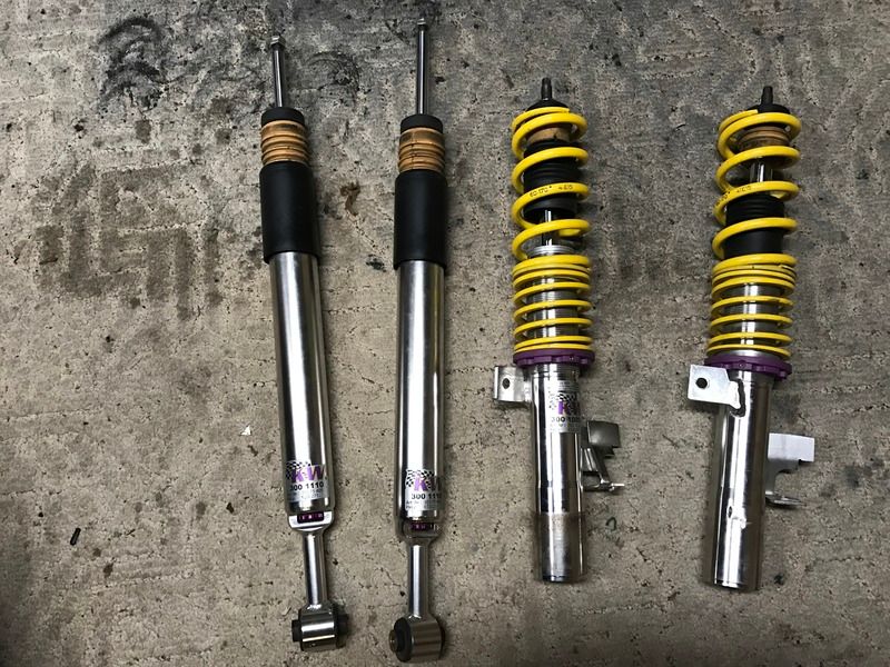

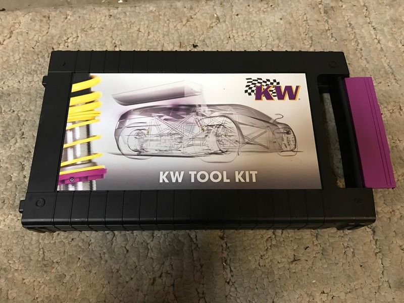

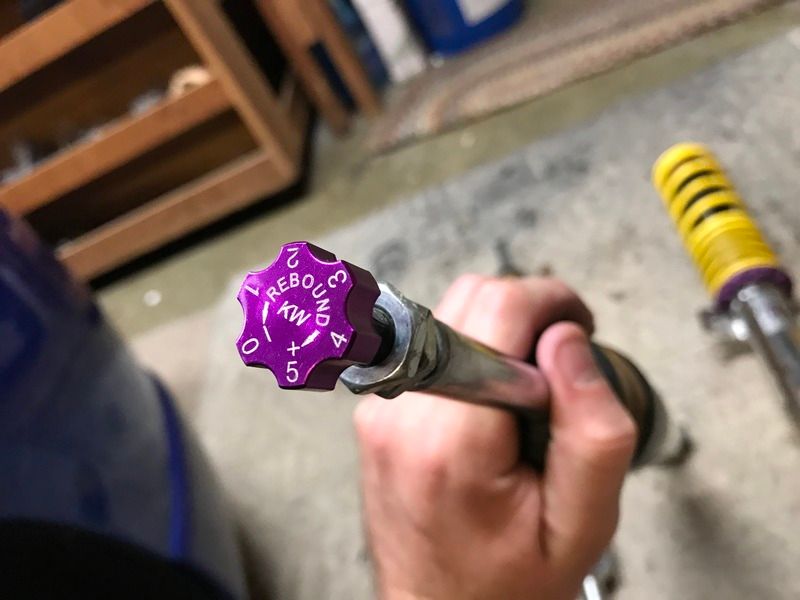

So latest development is a change in shocks for the Mazda3. The B14 Bilstein shocks that have graced the car since early 2014 have done a very admirable job, but I've been looking for more spring control as the current setup seems to be towards the upper limit of what the off the shelf Bilstein's can handle.
I have always eyeballed the KW Variant 3 or "V3" suspension for this budget oriented STF build, however the $2,200 retail price was more than I wanted to spend on this old beater. Luckily, I was able to secure a lightly used set recently for a significantly reduced price (Thanks Ken).
The V3's feature independently adjustable rebound and low speed compression damping. Nicely machined aluminum bits throughout. They are made in Germany and feature high grade stainless steel construction so corrosion and/or rust is a non issue. I'm looking forward to getting acquainted to these new shocks!
God I forgot how beautiful that suspension setup looks, makes me miss my Mazda.

Went through the car recently and performed some Spring maintenance along with installing the double adjustable KW dampers, new front brakes ect. I love EBC Yellow pads, but I'm going to give Hawk HP Plus a try up front for the first time. Thanks to Hawk's generous SCCA contingency program I have enough brake pads for the next 10 years, hope I like them as much as I liked the EBC pads.

The time has come to switch gears and take the Mazda in a new direction as STF unfortunately will not be a SCCA class in 2018. I had four good years in STF and will always look back on those years fondly. STF culminated at the 2017 SOLO Nationals last fall where the top 4 spots in class were taken by a Mazda3! Surprisingly not an Acura in sight because the top running Acuras had engine troubles last year. Danny Gross ended up taking the well earned STF title for final year the class was around. I followed him in 2nd place, with David Heddrick 3rd, and Ray Wise (my co-driver) in 4th. Again, all done in a Mazda3 which is pretty stinkin cool.
