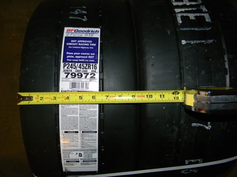

[quote author=PZ link=topic=210476.msg4235410#msg4235410 date=1338565243]
[quote author=Adam3s link=topic=210476.msg4235408#msg4235408 date=1338564894]
Same here as Steve, 40-50 runs with flipping and rotating is pretty typical in HS with the Hoosiers. If that kind of tire life isn't acceptable, then I'd run a different tire. I'm going to try the BFG R1-S at Blytheville next weekend....I hear it's pretty good. 245/45/16
Adam -
How hard was it to get the 245 BFG's on the rims?
Glad someone else decided to try these as I didn't want to buy a pair of 245's only to find that I couldn't get them on the rims.
As to the life before cording issues - maybe it's because Devens is asphalt, but, while there is a noticeable drop off in performance after 40 runs, I have gotten over 80 runs on my 245 Hoosiers before cording and the corded in the middle not the edge.
I'll let you know next week when I get them mounted. I don't think it should be a problem. The tires are squared off in profile like the Hankooks, and the rim protector looks similar as well. They may even be easier to mount, as the sidewall feels more flexible than either the Kooks or the Hoosiers. The stats listed on Tirerack are accurate, I measured 9.5" tread width for the 245's.
