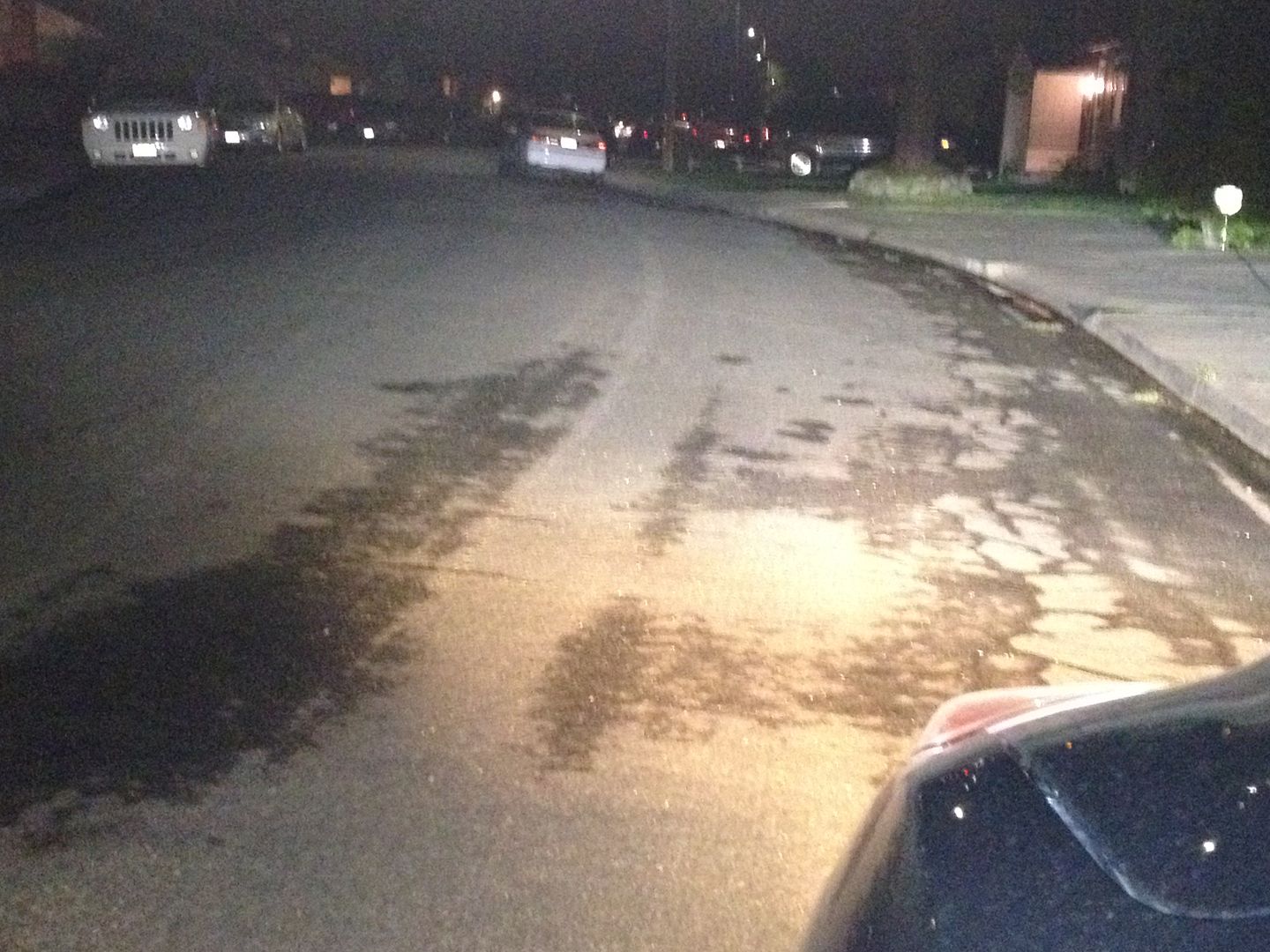

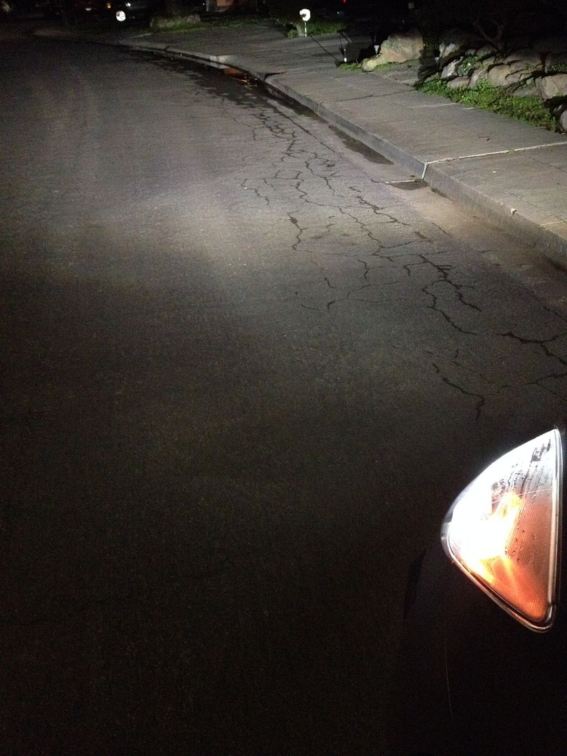

Still running the 100w yellow bulbs in the fog lights, and eventhough they are a little brighter than the stock 51w I removed, replacing them with HID or something brighter will be next. I might even remove them and look into the inner ring removal. Trial and error here, so if I mess up the housing, these are still available in both Mazda and aftermarket.
Headlights are stock for this model.
Fog lights are aimed as high as they can go stock.
Fog Lights Off
Fog Lights On

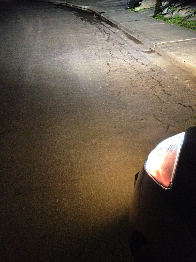

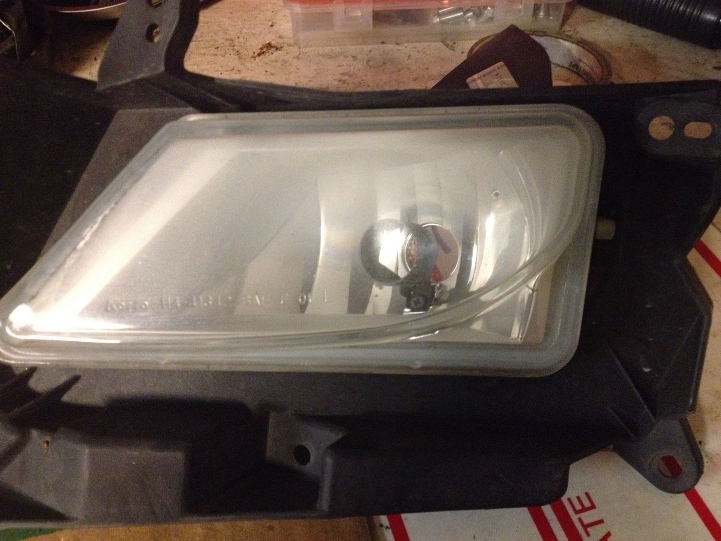

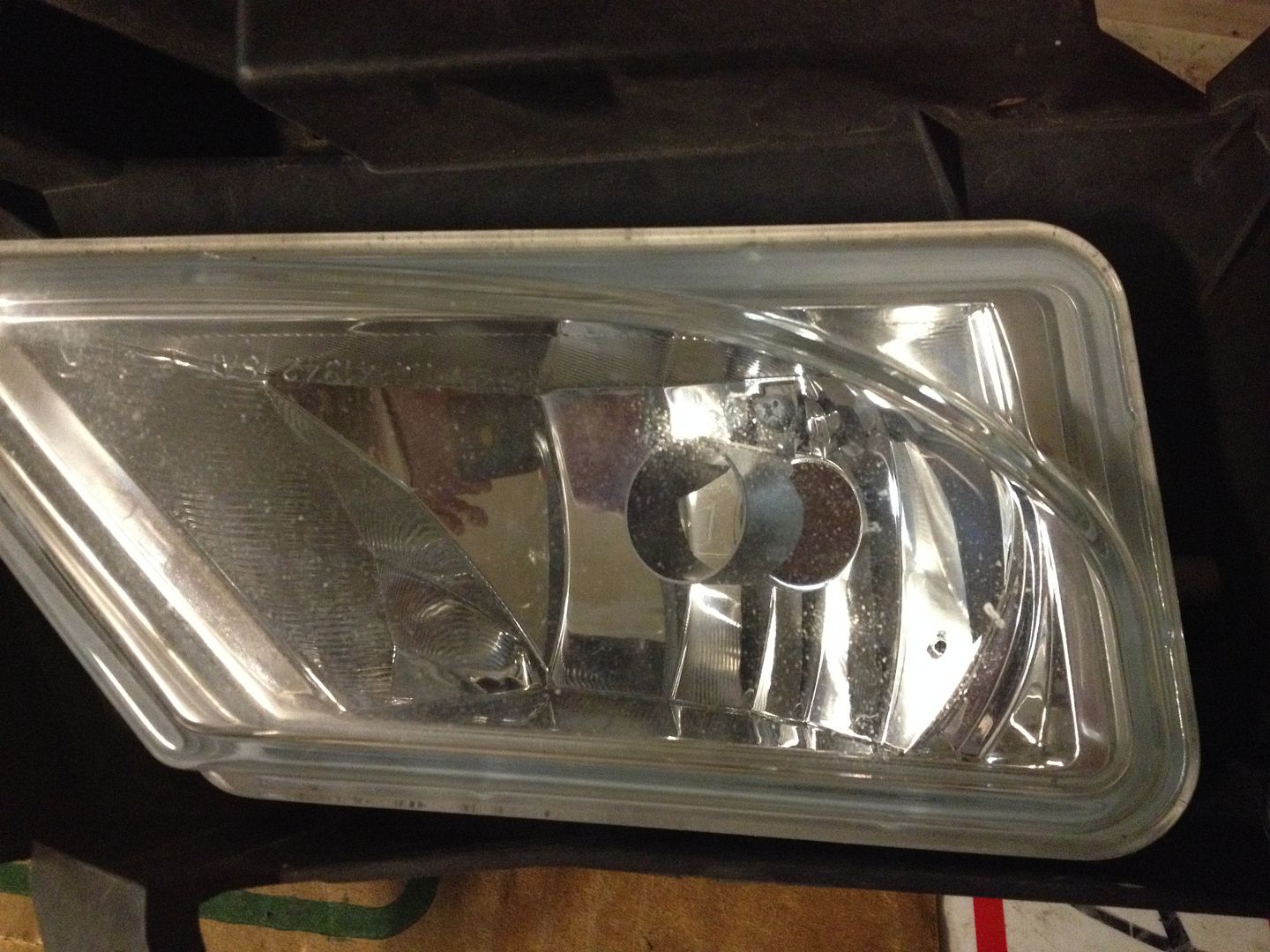

Replaced the stock fog light housings with new ones. Originals were faded, and not bright at all. I also cut out the inner ring that blocks most of the light. Running 100w yellow bulbs.
Driver Side:
Passenger Side:
Headlights on, fog lights off:
Headlights on, fog lights on:
I will aim the fog lights in a few days.

What a difference cleaning them made! Can believe that much dust/build up occurs inside them.
I noticed a huge difference in aiming mine in my 15. Can actually tell you have fog lights now!
