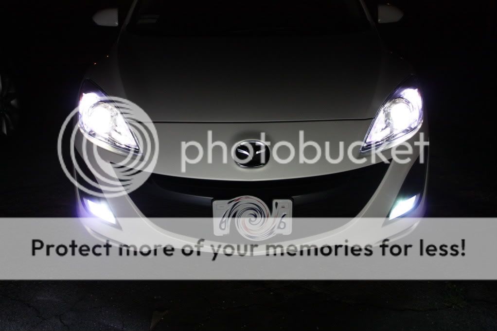

Head on

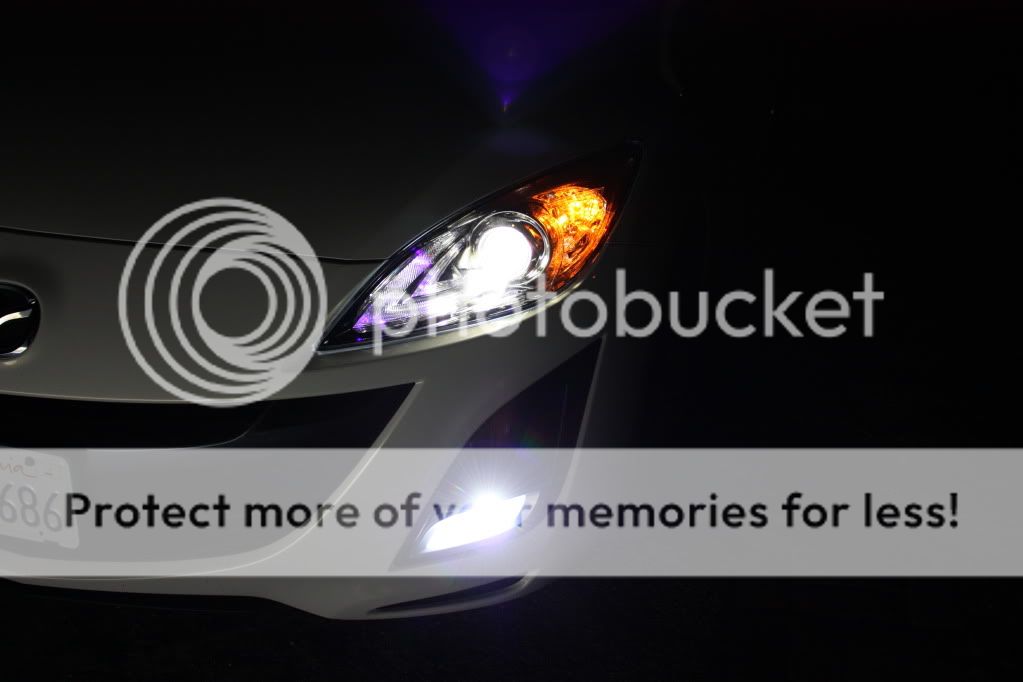

Side view with a lil lens flare

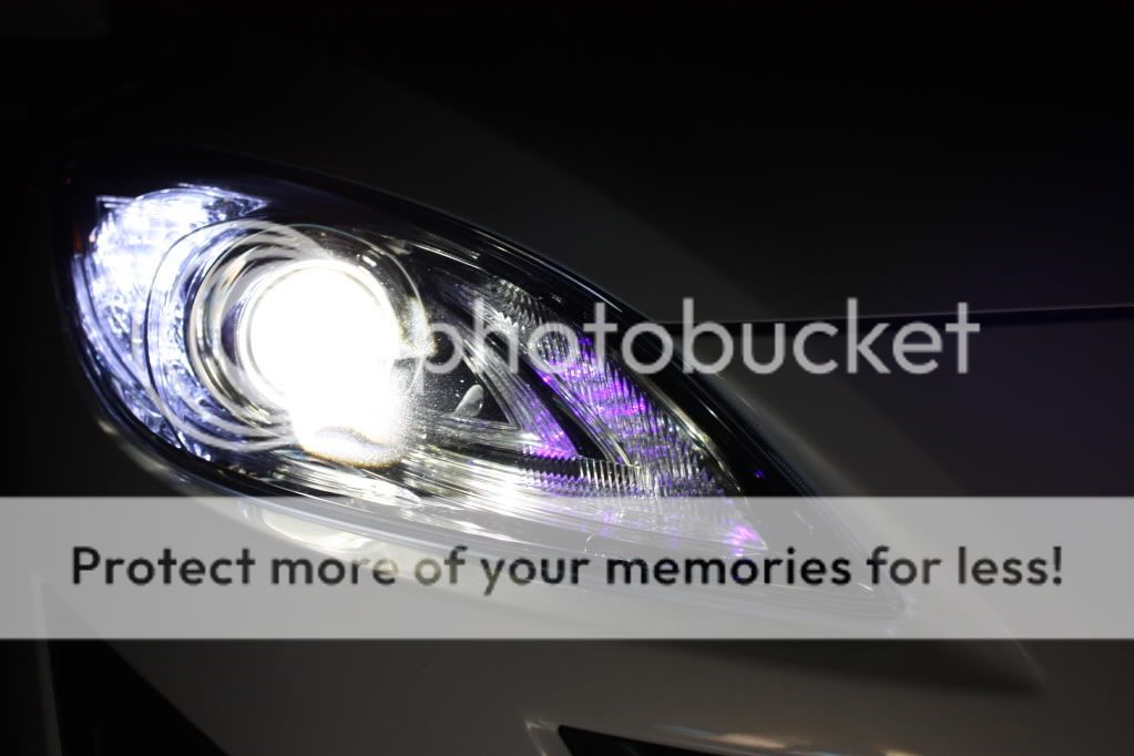

close up on the turn signals with my UV LED accent lights

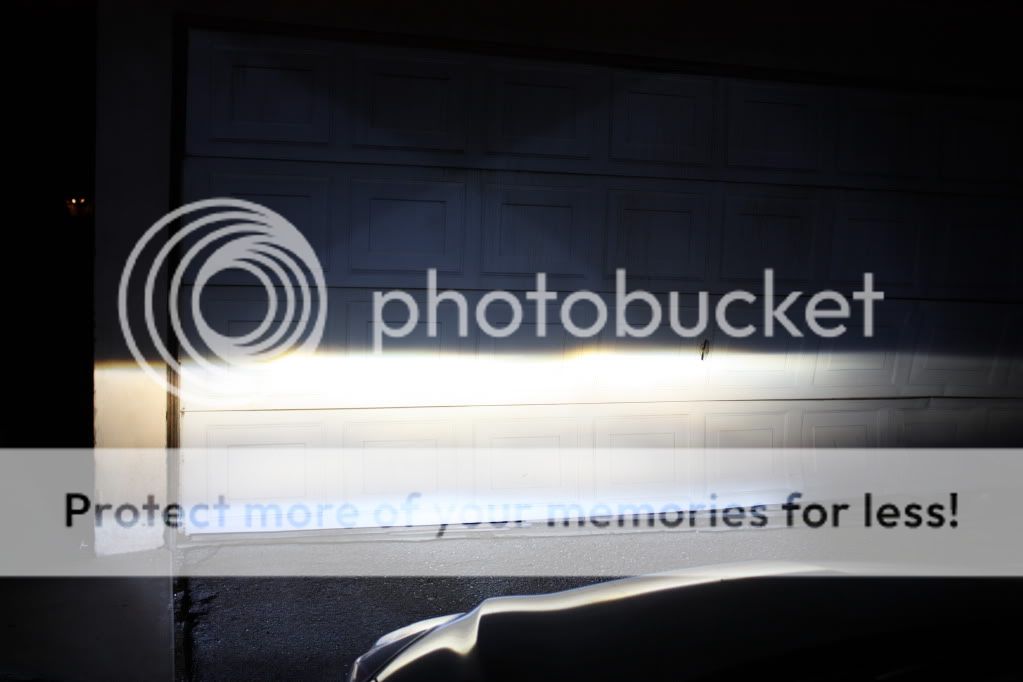

The cutoff

so the white in the upper corner is that crazy lookin LED bulb, right? and how did you do the UV LED accent lights?

Yeah that the LED turn signal bulb and the accent light is just a UV LED cluster that replaces the stocker.
