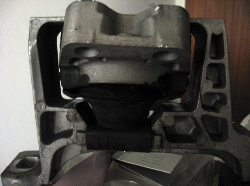

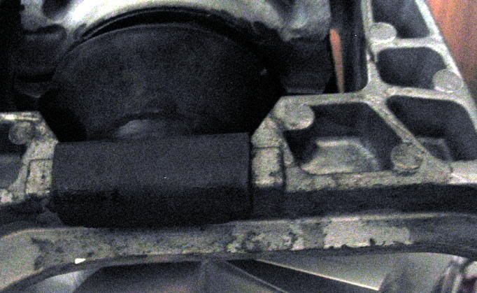

6) Check out your crappy fomoco part... it's destroyed... yay ford!

Also want to ask - is the Top Speed mount solid rubber, or hydraulic? Installed, does it feel similar to the oem mount, or stiffer?

it is supposed to be rubber. i examined it before i put it on... seems alot harder than stock... after test driving it for 5 miles it felt really good. no engine movement, i was chirping the tires easily.
