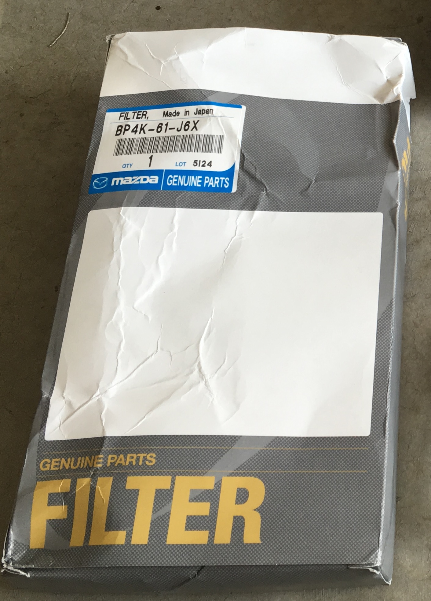

Here's my replacement filter (I paid $37.35 for it at my local dealership):
