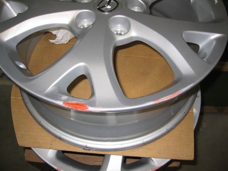

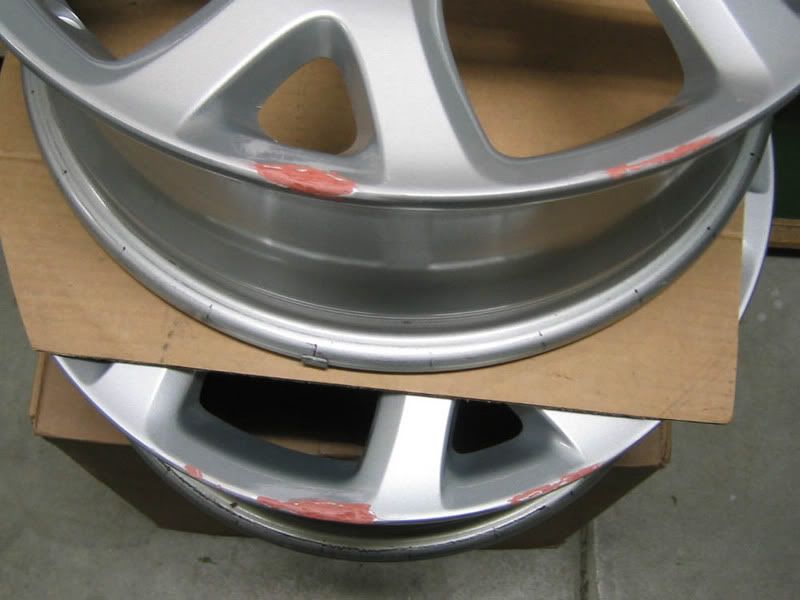

We first inspect the damage; it was pretty ugly. Some would say it's more of a gash than scratch.

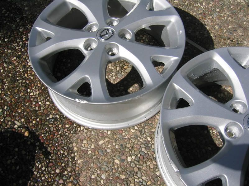

After cleaning the wheels, clean the area with paint thinner to take off any residue. I used 600 grit sandpaper to take off the burrs.

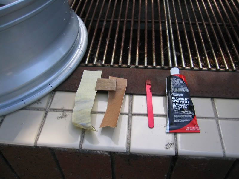

Here are the tools we will be using to patch up the area.

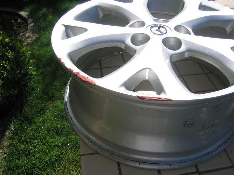

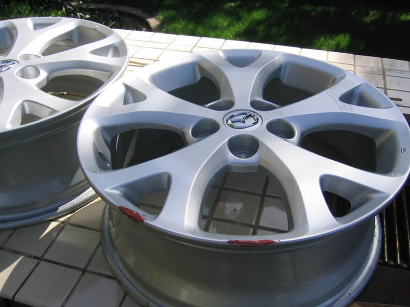

Use the popsicle stick to spread the putty onto the damaged areas. Remember to use small layers at a time or else it will take forever to dry and be prone to cracking when you try sanding. The top layer might be dry but when sanding further down to the moist area it gets messy. I learned the hard way and the pictures show too much putty. Using a hairdryer set on hot also helps the drying process.
The first sanding step with 400 grit sandpaper. DO NOT wet sand or the bondo gets moist and crumbles. This step gets all the excess bondo off. Using a small wooden block or popsicle stick wrapped with the sandpaper helps keep the surface you are sanding even. A finger does not do so well.
Add layers of bondo as necessary until the area feels smooth and even

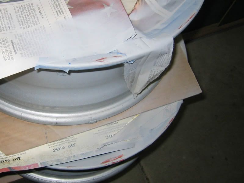

Primer the area and sand as necessary. This step I didn't do the correct method but it worked for me. In the link shown above, you're not supposed mask off the whole area. Instead, you just spray and clean up the surrounding areas with a rag soaked with paint thinner.

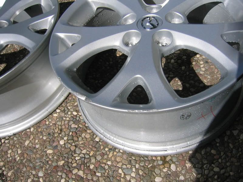

After a couple times of the previous step, lay down a nice layer of primer.
Primer build up at the areas where the masking tape meets the wheel will need to be sanded down to be smooth. This step I took off the tape and just used my finger and went along the lines. Buff the area, spray clear coat, then buff again with a soft cloth.

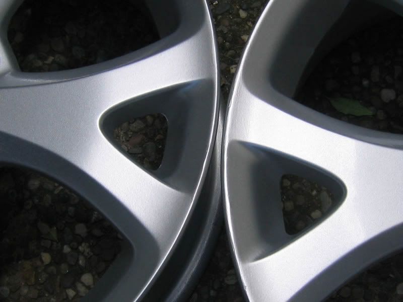

Finally, the ending result which I'm pretty happy with. For some reason the picture looks like the area near the scratched is lighter. This is actually due to the shade from the house on one side and fence on the other. The paint match is actually 99% correct. I asked the buyer to try and find the scuffed area and he had a hard time. Zee End!!

No but it can shrink...You really don't need bondo for this job...Theres not enough alloy missing...But if you don't have the right tools then yeah bondo will work...And when you paint a spotted area, instead of masking you're supposed to blend...That will alleviate the masking lines...
But overall for a non professional, not bad...But because I have a trained eye, no offense, I see where the repair is...One final coat of bondo would have done the trick...Or a thick filler...
